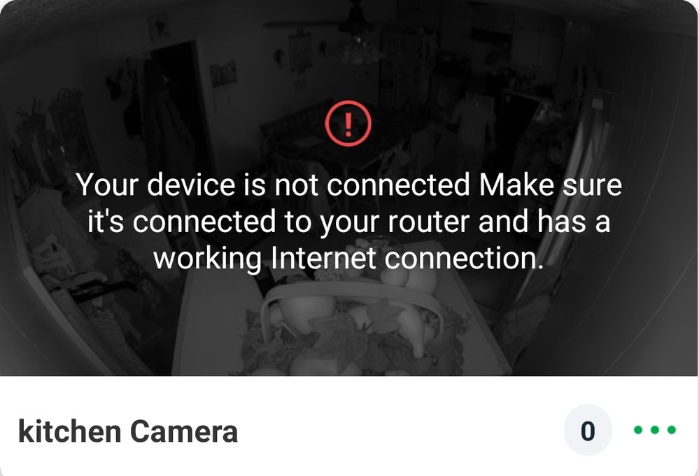

I only started having issues with the base station going offline for seemingly no reason on Friday last week. We had the same issue yesterday and then again this morning. Luckily today it was just before we were about to head off to work and I power-cycled the base station which appeared to resolve the issue. Resetting the base station through the app did SFA. However I would note that when the base station was apparently “offline” all the lights on the front of the unit were solid green. This makes me think that it’s yet ANOTHER base station firmware issue, possibly introduced when they were trying to resolve other issues like the time zone change.

our base stations keep going offline also
we got an inexpesive smart plus to be able to power cycle the base remotely becuase the interent still works - its just the base not connecting but power cycle gets it back. i have to keep checking my app throughout the day- its not always obvious the base is in the offline state- just the little wifi and battery icons are missing under each camera and the mode is getting information. we have not heard that there is any time for a fix for this problem and it has bean going on for weeks. we were told by one person in arlo tier 2 tech that this is their highest priotiy but that was about a week ago - not really sure what is going on. cannot really get a straight answer. there is no message on this from arlo community moderators.

I am using Arlo Pro 2 base station connecting 5 cameras. My base station is connected to my internet router directly using LAN cable. But since May 2019, my base station constantly goes offline (with middle LED indicator off) numerous times a day and sometimes it suddenly reboots by itself. My iPhone app also shows the base station has gone offline.
It is totally annoying. I am very disappointed in buying these unstable expensive systems. What is going on at all and how to fix it?

Same issue here. I'm having to reset system daily because of amber internet light stating no internet connection, this is getting ridiculous.  I've tried all suggestions on the forums and only wayo to get system back online is resetting base station daily.
