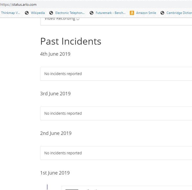

It is appalling that Arlo's "System Status" page is reporting "No Incident" over the past days, when in fact the system is chaotic!!
Everyone has their own standards. Arlo has theirs, we all have ours. Arlo thinks screwing with people's properties is fine, to us it's criminal.
