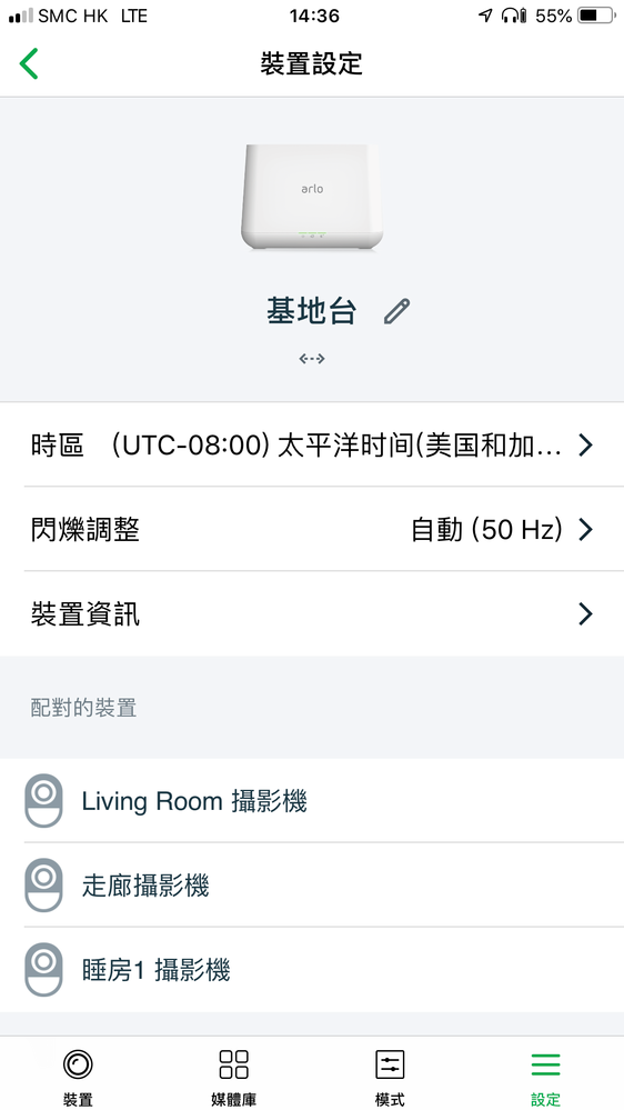

These days after my arlo pro VMS4330 updates to the latest firmware and Android Apps.
My system turned out to be a problem in saving Time Zone : (UTC + 07.00) in Jakarta,
and my local electricity frequency (Flicker Adjustment) : 50 Hz.
Within a day or 2 days I noticed my system unit would reset itself to return to Default Time
Zone : (UTC-08.00) Pacific Time (US & Canada) and the Flicker Adjustment returned to : Auto 60 Hz.
Please help and advice. thank you

Although I think the base changing time zones is not the cause of the problem, but the symptom of the base resetting itself to the factory default of Pacific time and going offline in the process. There is obviously something in the firmware update that the base station is unable to process, throwing it into reset mode.
