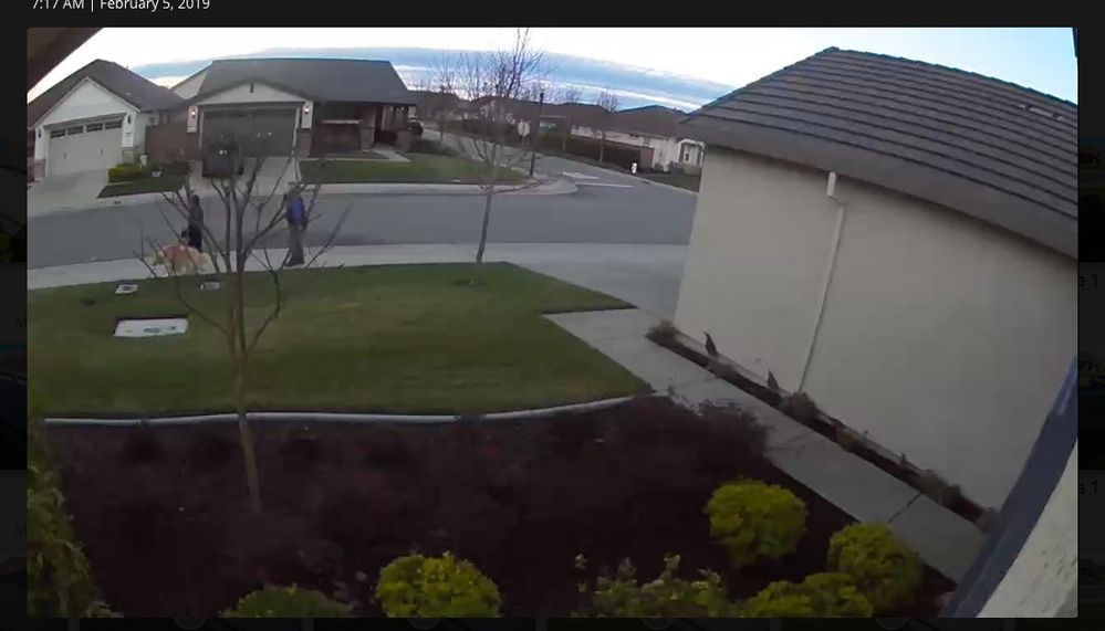

Thanks jguerdat, here are a couple of screen shots showing my activity zone and where the video starts.

Only one image with no zone. The big problems are 1) WAY too much view and 2) the sidewalk is too far and not enough motion across the FOV. What are you trying to capture - the sidewalk coming to the house? Rotating the camera to the right would help but a different mount may be needed.

Again, you have too much in the camera view. Also, almost everything is outside of the camera's useful detection range of ~25 feet for people. AT best you'd see cars going by (mainly due to reflecting the sun's IR) and maybe someone walking on your lawn. Is that really what you want to monitor? If so, I'd mount the camera on the house extension (garage?) on the right side of the view.

Yeah, thanks jguedat I've minimised the activity zone and positioned it to catch a portion of the walkway to the house and a corner of the sidewalk and it seems to be working pretty good right now.
