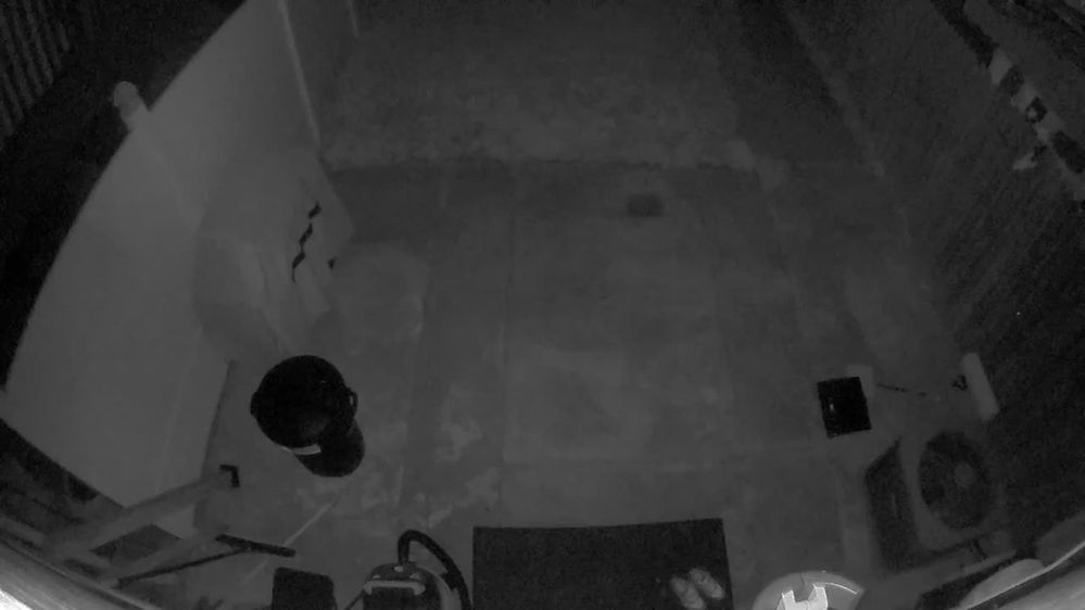

Attached are the pictures you requested. Arlo720P is the Pro and Arlo1080P is the Arlo2. As you can see the difference... one is brighter and one is not.
This is a night shot of the back yard, very grainy and washed out, cant really tell any details of the things back there. The arlo pro 1 was the complete opposite of this clarity.

Take a look at my view last night through the camera.... This is what Netgear considers "NIGHT VISION", it was raining last night but that isnt an excuse as my driveway arlo pro 2 did not look this bad last night, and through hail sleet and snow my Arlo Pro 1 never looked like this.... its sad...
My night vision view last night

While people are resolving their issues of grainy nightvision video by removing their skins, the other issue to still note is what's shown above. The Pro 2 nightvision overall is darker than the Pro nightvision.
