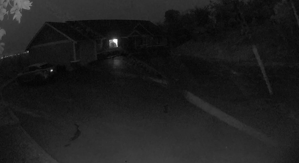

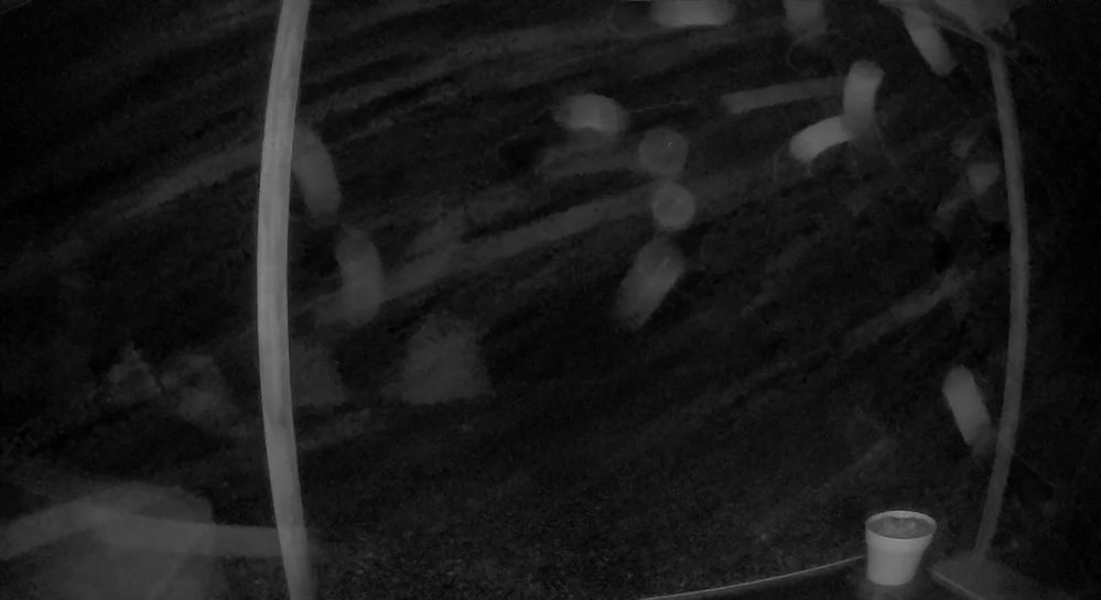

These two pics I saved from last night don't really represent how bad the presentation is. The one in the backyard atually caught two coyotes that wandered by that I looked and looked at the video and finally found them from their reflective eyes. In LIVE mode it's a continues stream of flashing smears.
and backyard
That's why I suggested the video links. Flashes aren't going to be seen/understood in stills.
Right Guru...had deleted the old files so here is a new one I created this morning. I tried playing with the brightness setting but using the chrome browser in LIVE mode it took me several minutes to just get it back to zero. The slider does not follow the mouse properly. Cannot get it above zero and under camera settings the brightness icon is not active (greyed out). Very frustrated.
https://arlo.netgear.com/hmsweb/users/library/share/link/BE9F6C60568AF84C_201901
Ok, that video was VERY descriptive and not at all what I expected to see. It appears to be a swarm of bugs reflecting the IR from the night vision LEDs.
The brightness control is not smoothly varying. It has distinct stops - a total of 5.
After much patience set both cameras to +1 brightness. Here is a video from the back of the house camera with no ambient light. There are 6 LEDs at the top of the camera (inverted U pattern) with 2 bright and 4 dimmer, plus 2 more bright LEDs in the middle of the camera (side-by-side) for a total of 8. Is this this a correct layout for the LEDs?
Maybe my question was not clear - should the 6 LEDs on the top of the camera all be of equal brightness? I have 2 bright and 4 dim. The 2 LEDs to either side of the lense itself are bright for a total of 8...4 bright 4 dim.

Thanks for looking last night...very kind. Do you have a pro or pro 2 because I see something a bit different. I have 6 at the top and 2 left/right of the lense. Looking at the camera without any angle 2 at the top and the 2 below are bright and form a rectangle of brightness (almost a square). The other 4 at the top present themselves differently. 1 on the left when viewed from a right angle becomes brighter, and 1 on the right when viewed from the left becomes brighter. 2 at the very top when viewed from an angle lower become brighter. So it appears 4 of the lights at the top are set at various angles to disperse the IR accordingly. The source of the distortion is fog. Here in the Rogue Valley, OR we get a lot of fog. Early last night before the fog the IR refraction was not present, then this morning with fog quite bad again. I would rate the image without fog moderate to poor, and with fog useless. Looked at various video clips of IR cameras through fog and although the results vary none are as bad as the arlo pro 2. So guess I need to decide whether to live with the flaw or send everything back. Shame as the daytime perfomance is brilliant.

The built-in LEDs have the same issue as driving in fog/snow with you headlights on - bounces right back into your vision. An offset source would minimize that effect and can be stronger so you get a better view of what's going on at a farther distance.
The Pro has better night vision primarily due to the pixel size of the sensor. Each increase in resolution but the same size sensor results in smaller pixel sizes and, hence, fewer photons hitting each cell. You can increase the sensitivity of each cell but then that also increases the background noise level at the same time, reducing the overall quality. Additional lighting of any sort eliminates the issue which maintaining the increased resolution of the P2.
Driving in fog: True, but I have viewed other IR cameras and whereas they exhibit haze etc. haven't seen anything as bad as the arlo pro 2 in fog. If resolution is the issue at 1080p then perhaps the arlo pro 3 will have two lenses, one for daytime and a 720p lense that is switched to when the LEDs turn on. I'm going to keep these and perhaps add a plain old 800 lumen LED non IR battery powered external light with a motion detector. Thanks for your help Guru!!!
