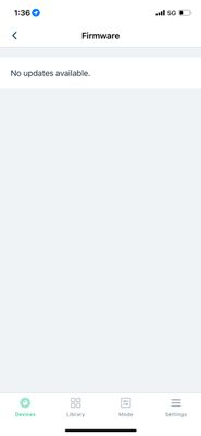

So I have had my Arlo for around 7 years now, the system has worked great without issue until yesterday. I noticed I was seeing no activity on my phone which is uncommon. I opened the app to find all 4 cameras saying "Arlo device appears to be offline" I then went to the devices tab of the app and it said the base station was offline. Figuring the power was out when I got home i figured a quick reset would do, man was I wrong.
When I checked the base station the light was flashing orange which is a WIFI issue obviously. My modem was running all other smart devices (82 total) in the home with no issue so i removed the power cord from the base station waited 5 minutes and plugged it back in. Unfortunately same blinking orange light. So I reset tried to sync pressing the sync button in for one second and had no luck same orange blinking light. I checked the firmware which was up to date 1.26.00-4612-12a0681, so then I reset the modem and again no luck but all other smart devices working flawlessly. This is when i decided to complete a factory reset. Once the factory reset was done I was able to pair the base station however the base station now shows a solid blue light indicating WIFI.
I then grabbed all 4 cameras, removed the batteries ensured they were all fully charged then reloaded a battery into 1 camera and began the pairing process through the app which failed. i then tried to pair the camera manually in the app which also failed. Then I attempted to log onto the Arlo website from my computer and add the camera from there which also failed. Its important to note when I attempt to sync the camera and base station blue lights beat the same with the base station eventually going solid blue and the camera going black. I tried individually pairing each camera but none would work so I attempted a factory reset on the camera itself. I held down the sync button on the camera waiting for the orange light but nothing happens.
I then went back into the app to see that the base station was offline despite being solid blue. I just want to get these cameras readded as we are going away soon. In the meantime I've heard that if you don't buy new Arlo subscriptions they are doing firmware updates to stop devices from being able to work, does anyone know if this is true?? Before the questions asked yes I'm using the same network when attempting to sync & no i have never had this issue ever before. Attached below is an example of what i see when i go into the app vs. looking on the physical arlo website.
Appreciate any feedback as I'm at the point where i might go buy a new home security system this weekend, thanks...
