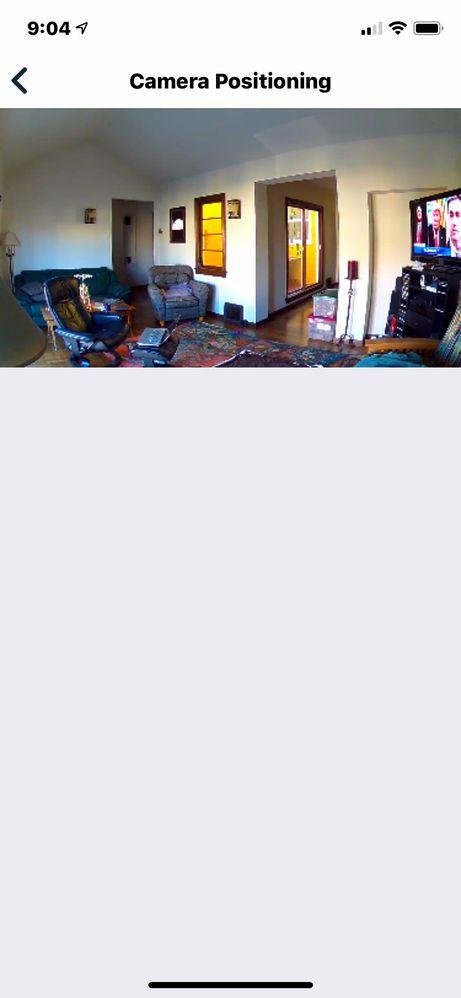

I set all 5 cameras side-by-side.  Using the Camera Positioning Utility and zooming out to 1.0 each time, I took these screenshots.  As you can see, one camera clearly stands out from the others.
good camera 1good camera 1Good Camera 2Good Camera 2Bad CameraBad CameraGood Camera 3Good Camera 3Good Camera 4Good Camera 4
