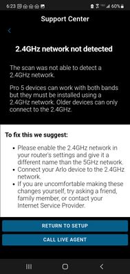

  13. "Your Hub could not connect to Aaaaaaa99_99-99. Make sure your network is online and the password that you entered is correct. Try Again / Need Help?" [Network name is representative where A is a capital character between A and Z and a is the same  in lowercase; 9 is a number from 0-9. There was mention of no punctuation in the network name, but the screenshot shows that other network names with underscore, and scrolling down including dashes, do display.]
  14. Attempt 1
    1. Press Try Again
    2. "Connect to device? ..." (screenshot)
    3. Connect
  15. Attempt2
    1. Press Need Help
    2. Speed Test Results
    3. 2.4GHz network not detected

GGarrison
Short version. It worked briefly.
Changing to "WPA3-Personal+WPA2-PSK[AES]" does allow the Arlo app / Keypad sensor to see the 2.4GHz network after VPN, IPv6, Smart Connect*, 5 GHz, and Guest network are disabled, numerous reboots of the router, and removing ("Forget") and adding the network back to the cell phone.
What was odd was that the app would show briefly as a connected client on the router when accessing the router via a browser. Then it would drop. Likewise, the Arlo app on the cell phone would notify of the keypad being added and then offline. (screenshots)
I am at a loss for words. Thank you SO much for your suggestions.
/ * “Smart Connect allows each of the router’s wireless bands to use the same wireless settings. The router can balance network demand and assign devices to the optimum band.”Screenshot_20231228-215126_Arlo Secure.jpg20231228_214912.jpg
