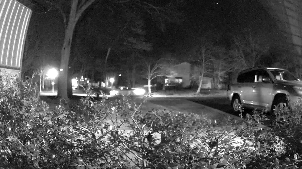

None of the cameras will operate at the distance you want.... The only camera that will detect at that range is no longer produced ( the Q cameras which had pixel change detection over the IR detection as in the cameras now ).... Not to mention the IR illumination drops off after 15-20 feet.
External IR floodlights will work if placed out far enough, the ones I have used cover 50ft which is a big improvement over the camera's IR, but still not enough to work for you.
Here's ( attached ) a pic from 75 feet away with a Q cam... the video is better but still at night the lights and motion wash out the pic/video enough to make them not really usable.
