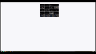

I am extremely disappointed with the performance of my Arlo Essential XL Spotlight's Live View. Thought, it seems to work perfectly fine on my android device through the Arlo app.
However, regardless of what pc, network, or web browser I use the live view for all of my cameras gets stuck buffering and waiting on the 3 dots or a "please wait" or even an error with a "request timed out".
I have 10 Essential XL Spotlights as well as 10 Arlo Go 2s that I have all bought within a month ago and, this live view function while on my desktop is critical for my case. As I said before the live view functions perfectly on my android phone when viewing them through the app, but no matter what I try the web portal's live view on my desktop pcs is terrible and I'm starting to think I'll have to return these 20 cameras and 20 solar chargers I bought with them... LOL I really hope that is not the case.
Here's an image of the web portal showing nothing but buffering
Since it works well on the phone, is this when using WiFi or cell service? If using the same network, is the computer using WiFi or a wired connection? Are you using a 3rd party Internet security package? You may want to disable that temporarily for testing. What router are you using? Any VPN in use?
When on my phone the live view works great regardless of whether I'm on cell reception or my home wifi. I've even tried connecting my pc to my phone's hotspot, but no difference.
All of the PCs I've tried this with were wired into the network, minus the time I tried my phone's hotspot.
No 3rd party internet security package.
Using an xfinity modem but all of my networking is done through my Ubiquity Dream Machine Pro.
No VPN either.

Unplugged and turned off the Dream Machine altogether and instead plugged in my AX4400 router that I had. Synced up 5 cameras to that wifi, logged into the web portal and still the same issue. Same with my Arlo Go 2s. It seems to sometimes work somewhat OK if I only play 1 or 2 cameras at a time, but this is unacceptable as I require the ability to live view all of my cameras whenever I need to!
I have a strong feeling the web portal just simply doesn't allow too much data transfer and it all just gets hung up when I try to live stream 8 or more devices at once. However this is a critical function for me, and I was under the impression that I could live view any of my cameras whenever I wanted to, but so far I can only do that on my mobile device and I cannot strictly use my android device for these cameras I need to be able to use my pc.
Any ideas?

It breaks pretty quickly on anything outside. Regardless if it is an LTE connected Arlo Go 2, a wifi connected Arlo Go 2, or an Essential XL Spotlight, if it is outside and I go to start playing more than 2 at a time they start to break. The Essential XL Spotlights that are inside are a lot more stable, but will still break as well.
I must reiterate that I can have 10+ live streaming devices all at once when on my Android device, but I need to be able to do this on my pc as well. It works flawlessly on the app. Is there another way for me to intercept the camera data on my network rather than going to the my.arlo.com website?
EDIT: These cameras and their current location all work perfectly live streaming all at once when viewed on my android device, but not on my desktop when using my.aro.com

Below is a youtube link to the video I made of how these systems act while trying to livestream 3 cameras at a time on the desktop.
https://youtu.be/4LjmKPi8Fz0
I don't know why I can't upload a video from my phone to this site.. I have to put it on youtube and give a link here that way. Irritating.
Anyhow, my system does the same thing. Have 9 cameras, and can stream all 9 at once on the phone.. home, phone running on wifi.. or away, running on data.
Try to stream more than two at a time while on the wired desktop.. and the system seizes up. If you set there a bit and don't move the mouse.. the third may finally show up and they'll all 3 go live... but move the mouse and add a 4th.. they all seize up.
On edit: I just tried it again...started out with one streaming... it's ok. Two... took a little to "load" and start streaming. Three: after it sat there and "loaded" a little bit... when the screen went live... it and the other two immediately started seizing up and took turns going "on and off" with the 3 dots.

I am severely disappointed with Arlo. Here is the reply I got from Arlo support.
"Please note that only 5 Arlo cameras can perform live streaming at the same time so for isolation kindly select only 5 cameras for live streaming and observe the status."
I mean @RegularJoe can also confirm that that's simply not true. I for sure can live view more than 5 at a time while on my phone.
There is a limitation of 5 simultaneous streams from a base station.
But if the cameras are connected to your home wifi (or multiple bases), then that limit does not apply. This KB article says that you can view up to 15 cameras in that case:
I'm tagging the mods ( @JamesC and @ShayneS ) so they can follow up - either with a correction to the KB article, or a clarification here.
Thanks @StephenB for finding that article! Sorry if my tone ever comes off as aggressive by the way, we just have been dealing with some intense things around our property and security is no joke right now.
