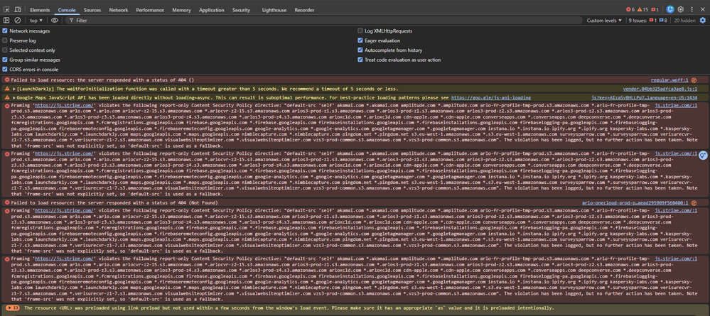

trainhater
Yes, while I haven't timed every error, everyone I have timed is 12-13 minutes after starting to stream. The amount of cameras streaming doesn't matter they all go down at once, whether 1, 2,3,4,5 are streaming.
Tried another computer with Microsoft Edge and same issue.
Tried the incognito mode last night, no difference.
I've tried each combination of cameras, it is always 12-13 minutes.
I disabled hardware acceleration as you said and again, no difference.
Everything is up to date on my computer, the only update I didn't have was for the Prime X870-p Wifi motherboard and after the update, still no change.
I I did this wrong or it is not what you need, let me know.
ShayneS
Thanks for the info, I was able to replicate with Chrome and safari. I have notified the appropriate team and I will report back as soon as possible.
