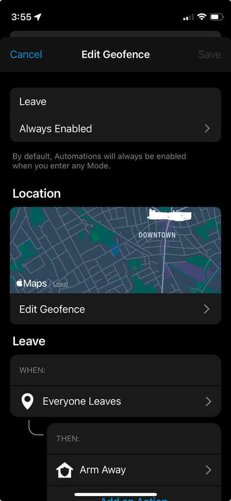

Here are sample geofencing automations you can use:
Make sure you set the "enable lists" (right below the automation names) as they are set in the examples.
