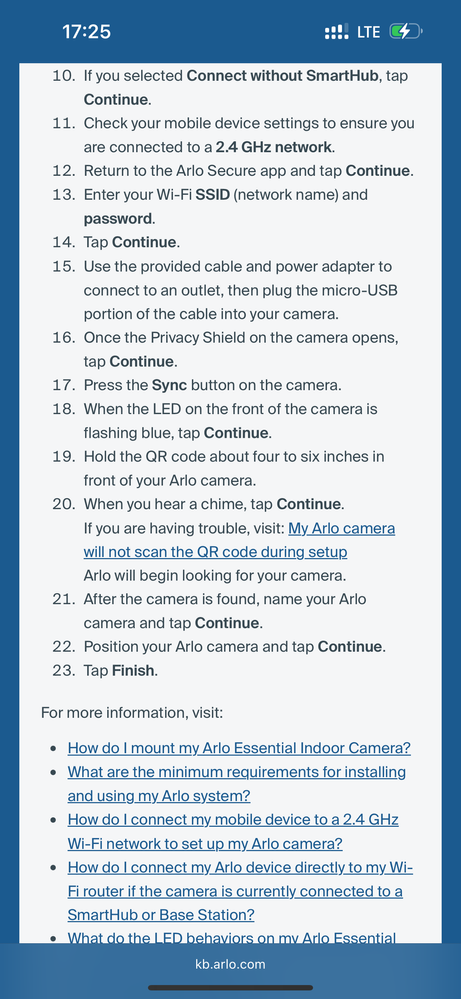

Notice step 9 - Continue Without SmartHub. That means you can connect to WiFi. It also means my comment about WiFi being the default is wrong since you have to select it manually.
Does it connects to WiFi ok? If so, did it update firmware which may be needed to connect to your hub?
Hey Guru!
Thank you so much for all your help. You pointing out a couple of words from step 9 did the trick for me. The camera is now connected to the WiFi network and is working fine.
I'll look into moving it completely onto the smarthub to avoid being dependent on the availability of the 2.4 GHz network.
Thank you again.
