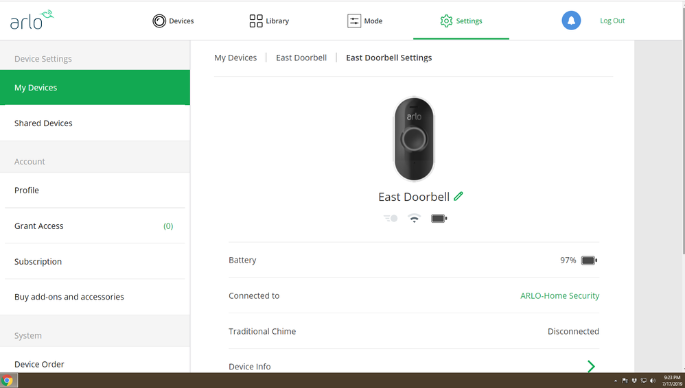

i found the Traditional Chime setting on the website (not the app) but it doesnt allow me to connect it, its stuck on disconnect... very frustrating.

I got my Arlo Audio Doorbell installed today, but the doorbell does not work with my mechanical doorbell. I have tried toggling the 2 and 3 but to no avail. I have read the troubleshooting posted here in the community and I am experiencing similar problems as others with regards to the app. I am unable to select traditional chime under settings of the Chime. You can't even click on the Chime and go any further with the app. Netgear please fix this. I then went on the www.arlo.netgear.com website to fix this problem and all I see is Traditional Chime: Disconnected.

When I look at the doorbell though the website it says:
Traditional Chime - Disconnected
