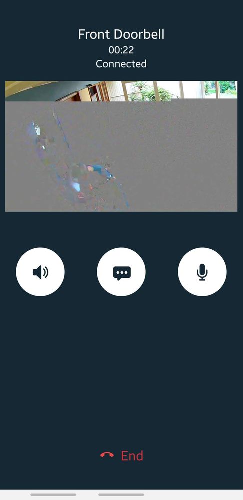

When I try to test my doorbell which is linked to a camera at the front door the image that appears once i accept the notification on my phone only has a fith of the screen shown at the top and the rest is static and greyed out. The audio lags and the camera stutters. Is it broken already?
Highlighted
Star
Star
Same issue here but I only get a tiny bit of image.
Highlighted
I'd guess it's a signal strength/quality issue. If you live view and manually record, does it do the same thing? What is the house exterior made of as well as overal home construction?
Highlighted
Star
Star
The camera is about 10 metres from the hub. If I go and view it manually it's perfectly fine. It's got full bars of connection.
Highlighted
Not sure what can cause this when live view works fine. The doorbell just provides the trigger. Try disabling the doorbell motion setting and create a mode/rule for the camera so it does the detection and recording.
